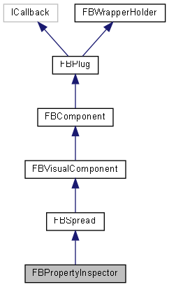

Property inspector class. More...
#include <fbuiutil.h>
Public Member Functions | |
| FBPropertyInspector () | |
| Constructor. More... | |
This class is used to inspect the properties of a component (including events) and display the information in a spreadsheet form.
Definition at line 67 of file fbuiutil.h.
Constructor.
| FBPropertyComponent Component |
Property: Component to inspect.
Definition at line 73 of file fbuiutil.h.
| FBStringList* Components |
List: Child components.
Definition at line 74 of file fbuiutil.h.
| FBStringList* Events |
List: Events associated.
Definition at line 75 of file fbuiutil.h.
