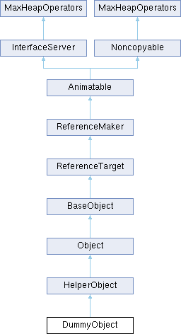

DummyObject Class Reference
#include <dummy.h>
+ Inheritance diagram for DummyObject:
