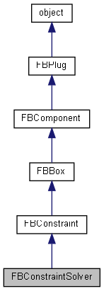

Base class for constraint solver. More...
#include <pyfbsdk_generated.h>
