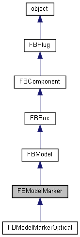

Model marker class. More...
#include <pyfbsdk_generated.h>
Public Member Functions | |
| FBModelMarker (str pName) | |
| Constructor. More... | |
