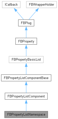

Inheritance diagram for FBPropertyListNamespace:
