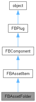

Class representing a folder stored in a version control database. More...
#include <pyfbsdk_generated.h>

Public Member Functions inherited from FBAssetItem | |

Public Member Functions inherited from FBComponent | |

Public Attributes inherited from FBPlug | |
