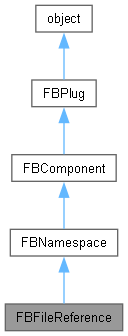

Objects Containing class. More...
#include <pyfbsdk_generated.h>

Public Member Functions inherited from FBNamespace | |
| FBNamespace (str pSingleLevelNamespace, FBNamespace pParentNSObj) | |
| Constructor. | |
| FBComponent | GetContent (int pIndex) |
| Get the namespace content object count (Not Recursive). | |
| int | GetContentCount () |
| Get the namespace content objects count (Not Recursive). | |
| GetContentList (FBComponentList pContentList, FBPlugModificationFlag pModificationFlags=kFBPlugAllContent, bool pRecursive=True, int pTypeInfo=FBPlug::TypeInfo, bool pExactTypeMatch=False) | |
| Get List of the namespace content. | |
Public Member Functions inherited from FBComponent | |
