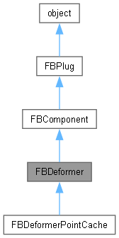

Base Model deformer class. More...
#include <pyfbsdk_generated.h>
Public Member Functions | |
| FBDeformer (str pName) | |
| Constructor. | |
Public Member Functions inherited from FBComponent | |
| FBComponent () | |
| Constructor. | |
| FBDeformer | ( | str | pName | ) |
Constructor.
| pName | Name of deformer. |
| FBDeformerType DeformerType |
Read Only Property: Deformer Type.
