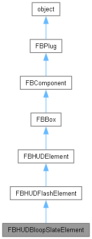

Heads Up display. More...
#include <pyfbsdk_generated.h>
Public Member Functions | |
| FBHUDBloopSlateElement (str pName) | |
| Constructor. | |
Public Member Functions inherited from FBHUDFlashElement | |

Heads Up display.
Bloop Slate HUD element. Display a bloop slate (swf) file rendered on the HUD.
| FBHUDBloopSlateElement | ( | str | pName | ) |
Constructor.
| pName | Name of new HUD flash element. |
