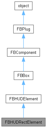

| | FBHUDRectElement (str pName) |
| | Constructor.
| | FBBox (str pName) |
| | Constructor.

Heads Up display.
Rectangle HUD element.
See sample: HUDElements.py.
