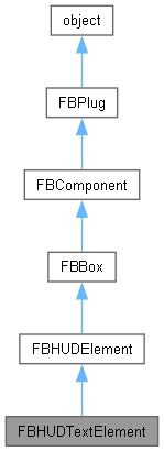

Heads Up display.
Text element. Render text with a background rectangle to the HUD.
