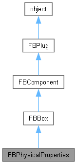

Inheritance diagram for FBPhysicalProperties:

Detailed Description
Base class for physical properties attach to a model.
See sample: RigiBody.py.
