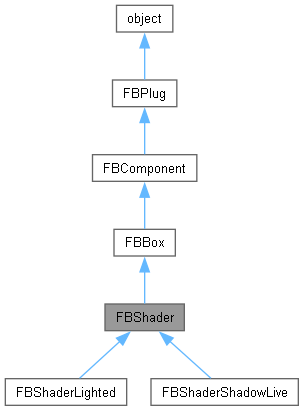

Inheritance diagram for FBShader:

Detailed Description
Shader class.
