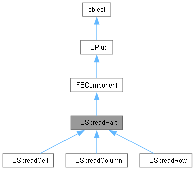

Spreadsheet part. More...
#include <pyfbsdk_generated.h>
Public Attributes | |
| int | Column |
| Read Only Property: Column number. | |
| bool | Enabled |
| Read Write Property: Is SpreadPart enabled? | |
| FBTextJustify | Justify |
| Read Write Property: Text justification for SpreadPart | |
| bool | ReadOnly |
| Read Write Property: Is SpreadPart read-only? | |
| int | Row |
| Read Only Property: Row number. | |
| FBCellStyle | Style |
| Read Write Property: Style of cell | |

Spreadsheet part.
Due to protected constructor, this can only be created by a child object.
| int Column |
| bool Enabled |
| FBTextJustify Justify |
| bool ReadOnly |
| int Row |
| FBCellStyle Style |
