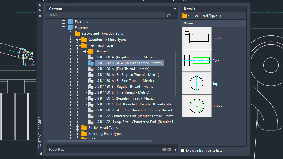

Content Library
  • Obsolete standard parts are removed from the Content Library.
  • Steel shapes are now displayed in order.
  • Error messaging is no longer displayed for circlips for bores.
  • Measurements are now updated when steel shape representation is changed.
  • The Content Manager now retains its position when resized.
  • The Content Editor contextual tab is now closed when the ribbon is turned off.
