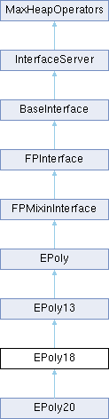

EPoly18 Class Referenceabstract
This new class extends EPoly with new functionality, for new hard/smooth edge workflow. More...
#include <C:/adskgit/3dsmax/3dsmax/3dswin/src/maxsdk/include/iepoly.h>
Inheritance diagram for EPoly18:
