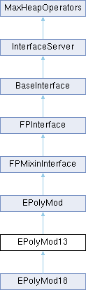

3ds Max C++ API Reference
This new class extends EPolyMode, in particular adds a more efficient way for setting several vertex positions, and the ability for EPolyMod to support manipulate grips. More...
#include <C:/adskgit/3dsmax/3dsmax/3dswin/src/maxsdk/include/iEPolyMod.h>
