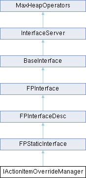

Inheritance diagram for IActionItemOverrideManager:
