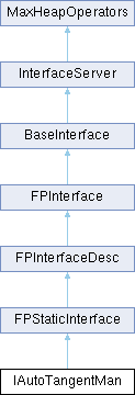

Inheritance diagram for IAutoTangentMan:
