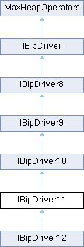

Inheritance diagram for IBipDriver11:

Detailed Description
Interface into the biped driver controller for Max 11.
This contains functions supporting new biped features in Max 11.
