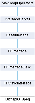

Inheritance diagram for IBitmapIO_Jpeg:

Detailed Description
See also
Class FPStaticInterface
Description:
This class represents the interface for the Bitmap IO JPG format. The interface ID is defined as BMPIO_INTERFACE.
All methods of this class are Implemented by the System.
