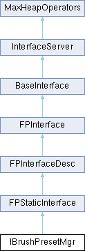

Inheritance diagram for IBrushPresetMgr:
