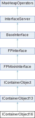

Inheritance diagram for IContainerObject16:
