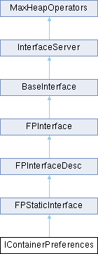

Inheritance diagram for IContainerPreferences:
