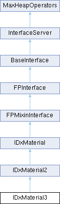

3ds Max C++ API Reference
#include <C:/adskgit/3dsmax/3dsmax/3dswin/src/maxsdk/include/IDxMaterial.h>
Public Member Functions | |
| virtual IEffectParser * | GetCurrentParser ()=0 |
| Access to the current active parser for the loaded effect file. | |
| virtual INode * | GetLightNode (D3DXHANDLE handle)=0 |
| Get the active light node based on the D3DXHANDLE. | |
| virtual IParameterManager * | GetCurrentParameterManager ()=0 |
| Get the active Parameter Manager. | |
| virtual int | GetNumberOfTechniques ()=0 |
| Get total number of Techniques. | |
| virtual const MCHAR * | GetTechniqueName (int index)=0 |
| Get the technique name. | |
| virtual const MCHAR * | GetCurrentTechniqueName ()=0 |
| Get the active technique name. | |
| virtual ILightManager * | GetCurrentLightManager ()=0 |
| Get the active light manager. | |
