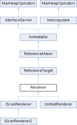

Inheritance diagram for Renderer:

This is the base class for any renderer plugin.
The main entry points for this class are methods Open(), Render(), and Close(). Any render operation works as follows:
  1. Open() is called exactly once.
  2. Render() is called zero or more times.
  3. Close() is called exactly once.
See also
Class ReferenceTarget, Class FrameRendParams, Class RendProgressCallback, Class IRendParams, Class INode, Class ViewParams, Class RendParamDlg, Class RendParams, Class DefaultLight.
