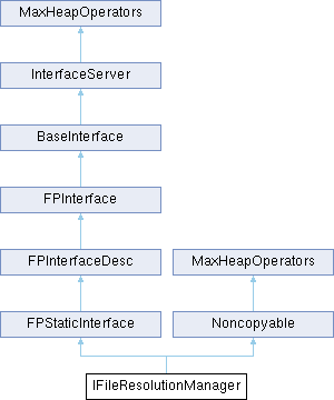

Inheritance diagram for IFileResolutionManager:
