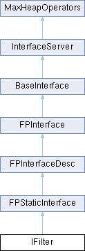

3ds Max C++ API Reference
Interface for perfoming workbench filter functions This class peforms workbench functions related to the filtering of fcurves. More...
#include <C:/adskgit/3dsmax/3dsmax/3dswin/src/maxsdk/include/CS/AnimationWBImp.h>
Filter can occur without any previous analysis. You get this interface by calling GetCOREInterface(FILTER_INTERFACE)
