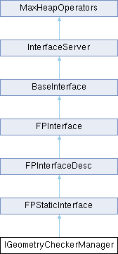

Inheritance diagram for IGeometryCheckerManager:
