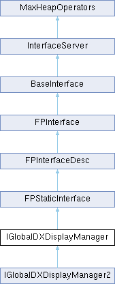

Inheritance diagram for IGlobalDXDisplayManager:
