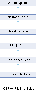

Inheritance diagram for IICEFlowFileBirthSetup:
