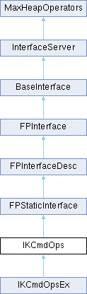

IKCmdOps Class Referenceabstract

Inheritance diagram for IKCmdOps:
