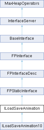

Inheritance diagram for ILoadSaveAnimation:

Detailed Description
The interface to the functionality for loading saving XML animation files.
This class contains key functionality for saving and creating both animation and map files and for loading in animation. You get this interface by calling GetILoadSaveAnimation()
