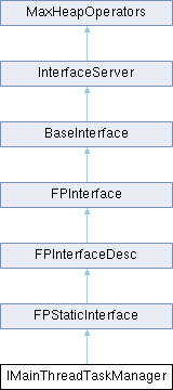

Inheritance diagram for IMainThreadTaskManager:
