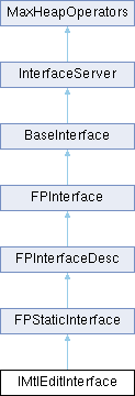

Inheritance diagram for IMtlEditInterface:
