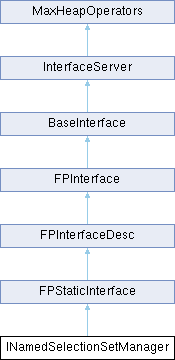

Inheritance diagram for INamedSelectionSetManager:
