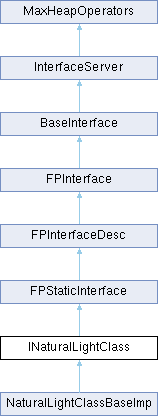

Inheritance diagram for INaturalLightClass:
