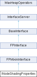

Inheritance diagram for INodeShadingProperties:
