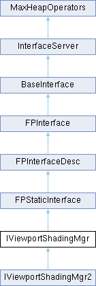

Inheritance diagram for IViewportShadingMgr:
