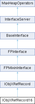

3ds Max C++ API Reference
This interface extends IObjXRefRecord interface. More...

| Public Member Functions inherited from IObjXRefRecord | |

| Public Member Functions inherited from FPMixinInterface | |

| Public Member Functions inherited from FPInterface | |

| Public Member Functions inherited from BaseInterface | |

| Public Member Functions inherited from InterfaceServer | |
