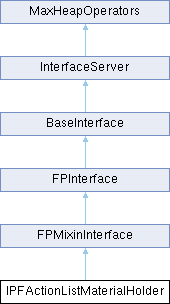

Inheritance diagram for IPFActionListMaterialHolder:
