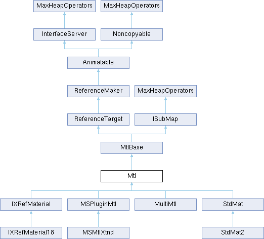

Inheritance diagram for Mtl:

Class MtlBase, Class Texmap, Class ShadeContext, Class ShadeOutput, Class Interval, Class Color.
Description:
This is the base class for the creation of material plug-ins. This class provides methods to do things such as compute the properties of the material for a given location, return the number of sub-materials and access the properties of the material for the interactive renderer.
Plug-In Information:
Class Defined In IMTL.H
Super Class ID MATERIAL_CLASS_ID
