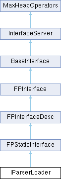

IParserLoader Class Referenceabstract
A core interface used to store parser DLLs found in the system. More...
#include <C:/adskgit/3dsmax/3dsmax/3dswin/src/maxsdk/include/RTMax.h>
Inheritance diagram for IParserLoader:
