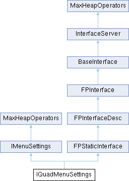

Inheritance diagram for IQuadMenuSettings:
