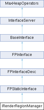

Inheritance diagram for IRenderRegionManager:
