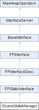

Inheritance diagram for ISceneStateManager:
