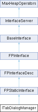

Inheritance diagram for ITabDialogManager:
