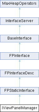

Inheritance diagram for IViewPanelManager:
