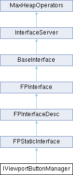

Inheritance diagram for IViewportButtonManager:
