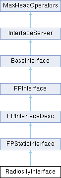

Inheritance diagram for RadiosityInterface:
